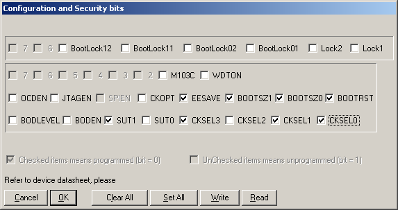

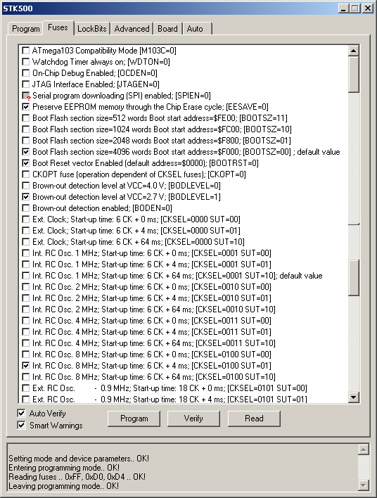

Fuse Settings in AVR-Studio and PonyProg2000
Not tested in PonyProg2000!
Fuse Settings in PonyProg2000
