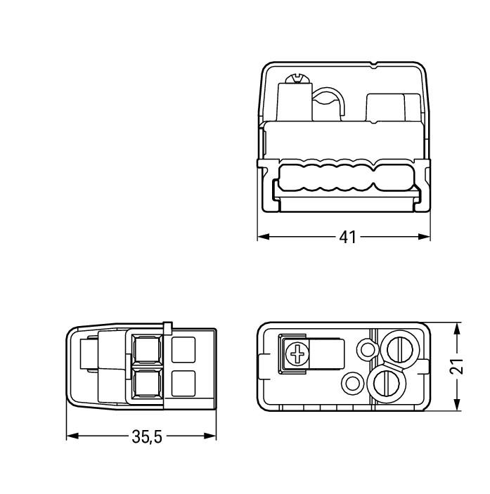

Wago 893-261
Actuation typeOperating tool
Цветgray
Conductor diameter0.8
Connection technologyScrew clamp connection
Connection technology 2IDC connection
Contact materialCopper or copper alloy, surface-treated
Country of originCH
Degree of protectionIP20
Габариты: глубина21 mm / 0.827 inch
Flammability class per UL94V0
GTIN4045454267285
Height35.5 mm / 1.398 inch
Insulating materialPolyamide 66 (PA 66)
Legend (ratings)(III / 3) ≙ Overvoltage category III / Pollution degree 3
Mating force of a plug-in connectionapprox. 30–70N (depending on number of poles)
Mismating protectionYes
Number of Poles2
Product Group20 (WINSTA)
Rated current3 A
Rated impulse voltage (III / 3)0.8 kV
Rated voltage (III / 3)50 В
Reaction to fire class per EN 50575Eca
Strip length5 … 6 mm / 0.2 … 0.24 Inch
Surrounding air (operating) temperature-35 … 85 °C
Unmating force of a plug-in connectionwhen unlocked: approx. 15–20N
Вес26 г
Ширина41 mm / 1.614 inch
