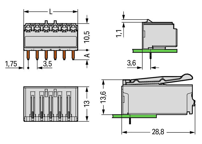

Розетка под пайку THT; 0.4 x 0.9 mm solder pin; угловые; Шаг контактов 3,5 мм; 6-пол.
Цены
Maybo
2091-1326
Wago
LED-драйверы MOSO – надежные и качественные ИП в линейке поставок КОМПЭЛ
Wago 2091-1326/200-000
Цветlight gray
Connector connection typefor PCBs
Contact materialCopper alloy
Contact platingtin-plated
Contact type (pluggable connector)Female connector/socket
Country of originDE
Габариты: глубина13 mm / 0.512 inch
Fire load0.075 MJ
Flammability class per UL94V0
GTIN4050821395997
Height14 mm / 0.551 inch
Height from the surface11.6 mm / 0.457 inch
Insulating materialPolyphtalamide (PPA GF)
Legend (ratings)(III / 2) ≙ Overvoltage category III / Pollution degree 2
Limit temperature range-60 … +100 °C
Material groupI
Mismating protectionNo
Number of Poles6
Number of levels1
PCB contactTHR
Pin spacing3.5 mm (0.138 inch)
Plated through-hole diameter (THR)1.2 (+ 0.1) мм
Rated current10 A
Rated impulse voltage (II / 2)2.5 kV
Rated impulse voltage (III / 2)2.5 kV
Rated impulse voltage (III / 3)2.5 kV
Rated voltage (II / 2)320 В
Rated voltage (III / 2)160 В
Rated voltage (III / 3)160 В
Solder pin dimensions0.4 x 0.9 mm
Solder pin length2.4 мм
Total number of potentials6
Вес3.19 г
Ширина21 mm / 0.827 inch
