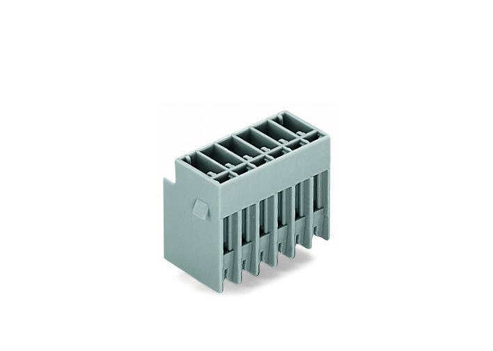

Вилка THT; 1.0 x 1.0 mm solder pin; прямые; Шаг контактов 5 мм; 2-пол.

Actuation type | Operating tool |
Цвет | gray |
Connector connection type | for PCBs |
Contact type (pluggable connector) | Male connector/plug |
Country of origin | PL |
Габариты: глубина | 18.3 mm / 0.72 inch |
GTIN | 4055143296441 |
Height from the surface | 22.2 mm / 0.874 inch |
Legend (ratings) | (III / 3) ≙ Overvoltage category III / Pollution degree 3 |
Mating direction to the PCB | 90 ° |
Mismating protection | No |
Number of Poles | 2 |
Number of levels | 1 |
PCB contact | THT |
Pin spacing | 5 mm / 0.197 inch |
Rated current | 32 A |
Rated impulse voltage (III / 2) | 4 kV |
Rated impulse voltage (III / 3) | 4 kV |
Rated voltage (III / 2) | 500 В |
Rated voltage (III / 3) | 250 В |
Solder pin dimensions | Solder pin 1 x 1 mm |
Total number of potentials | 2 |
Вес | 2.464 г |
Ширина | 13.6 mm / 0.535 inch |
