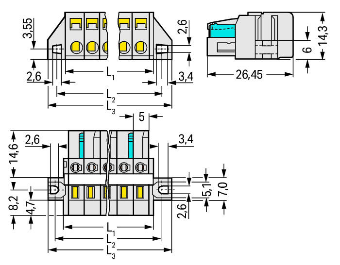

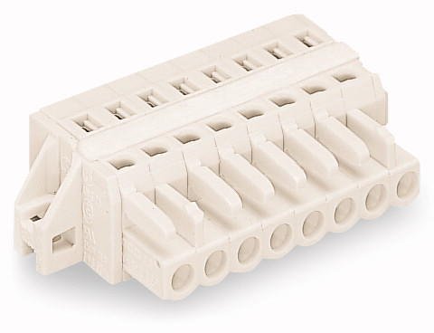

1-проводниковая розетка; 100% защита от неправильного подсоединения; зажимное кольцо; 2,5 мм²; Шаг контактов 5 мм; 14-пол.
Цены
Maybo
721-114/027-000
Wago
LED-драйверы MOSO – надежные и качественные ИП в линейке поставок КОМПЭЛ
Wago 721-114/027-000
Actuation typeOperating tool
Clamping spring materialChrome nickel spring steel (CrNi)
Цветlight gray
Connection technologyCAGE CLAMP®
Connector connection typefor conductors
Contact materialCopper alloy
Contact platingtin-plated
Contact type (pluggable connector)Female connector/socket
Country of originDE
Габариты: глубина26.45 mm / 1.041 inch
Fine-stranded conductor0.08 … 2.5 mm² / 28 … 12 AWG
Fine-stranded conductor with ferrule with plastic collar0.25 … 1.5 mm²
Fine-stranded conductor with ferrule without plastic collar0.25 … 2.5 mm²
Fire load0.383 MJ
Flammability class per UL94V0
GTIN4044918355834
Height14.3 mm / 0.563 inch
Insulating materialPolyamide 66 (PA 66)
Legend (ratings)(III / 2) ≙ Overvoltage category III / Pollution degree 2
Limit temperature range-60 … +85 °C
Material groupI
Mismating protectionYes
Mounting typeMounting flange
Number of Poles14
Number of connection types1
Number of levels1
Pin spacing5 mm (0.197 inch)
Product Group3 (Multi Conn. System)
Rated current16 A
Rated impulse voltage (II / 2)4 kV
Rated impulse voltage (III / 2)4 kV
Rated impulse voltage (III / 3)4 kV
Rated voltage (II / 2)630 В
Rated voltage (III / 2)320 В
Rated voltage (III / 3)320 В
Solid conductor0.08 … 2.5 mm² / 28 … 12 AWG
Strip length8 … 9 mm / 0.31 … 0.35 Inch
Total number of connection points14
Total number of potentials14
Type of mountingFeed-through mounting Panel mounting
Вес26.018 г
Ширина84.8 mm / 3.339 inch
with reinforcing strip1
