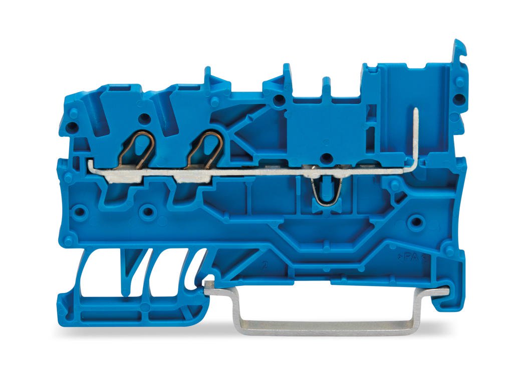

Datasheet Wago 2020-1304 — Даташит
X-COM S-Mini несущая/проходная клеммная колодка; монтаж на рейку; 2-проводная, 1-контактная; ширина 3,5 мм; синяя
Цены
Контрольные выводы REORD 569-TL245 | |||
2020-1304 Wago | по запросу | ||
RTL202013/04 Meterman | по запросу |
Actuation type | Open Tool Slot |
Цвет | blue |
Connectable conductor materials | Copper |
Connection technology | Push-in CAGE CLAMP® |
Country of origin | DE |
Габариты: глубина | 58.2 mm / 2.291 inch |
Design | horizontal |
Fine-stranded conductor | 0.14 … 1.5 mm² / 24 … 16 AWG |
Fine-stranded conductor with ferrule, push-in termination, from | 0.5 mm² / 20 AWG |
GTIN | 4055143278829 |
Height from upper-edge of DIN-35 rail | 32.5 mm / 1.28 inch |
Legend (ratings) | (III / 3) ≙ Overvoltage category III / Pollution degree 3 |
Marking level | Center/side marking |
Nominal cross section | 1 mm² |
Number of connection points | 1 |
Number of connection points (connection type) | 2 |
Number of levels | 1 |
Packaging type | BOX |
Rated current | 13.5 A |
Rated impulse voltage (III / 3) | 6 kV |
Rated voltage (III / 3) | 500 В |
Solid conductor | 0.14 … 1.5 mm² / 24 … 16 AWG |
Solid conductor, push-in termination | 0.5 … 1.5 mm² / 20 … 16 AWG |
Strip length | 9 … 11 mm / 0.35 … 0.43 Inch |
Total number of connection points | 2 |
Total number of potentials | 1 |
Type of mounting | DIN-35 rail |
Type of wiring | Front-entry wiring |
Вес | 4.53 г |
Ширина | 3.5 mm / 0.138 inch |
