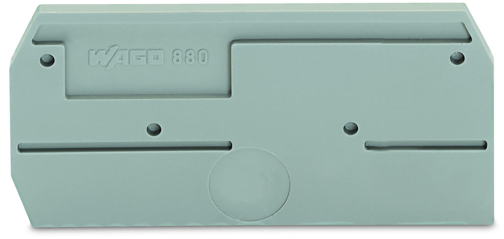

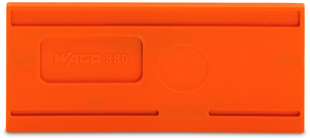

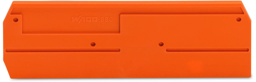

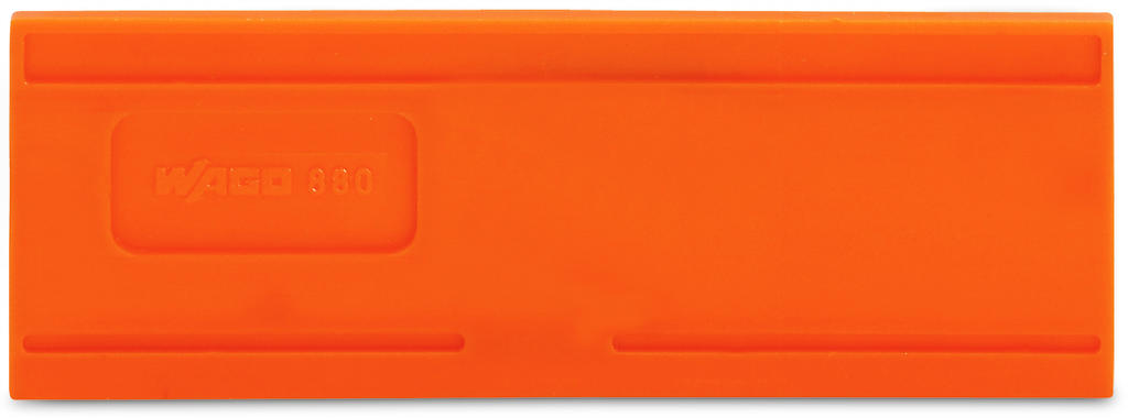

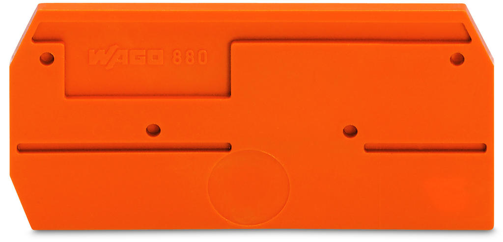

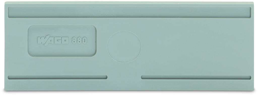

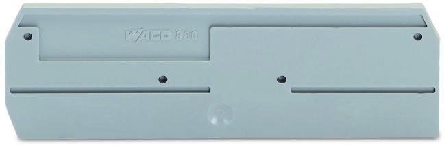

END AND INTERMEDIATE PLATE; 2.5 | |||
880-308 Wago | по запросу | ||

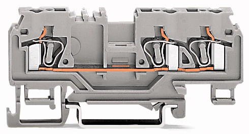

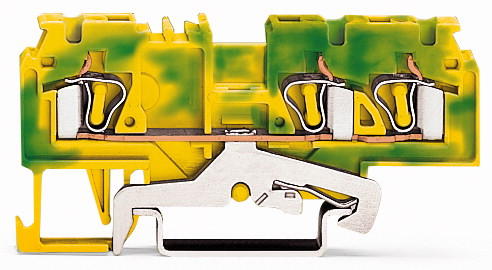

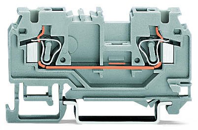

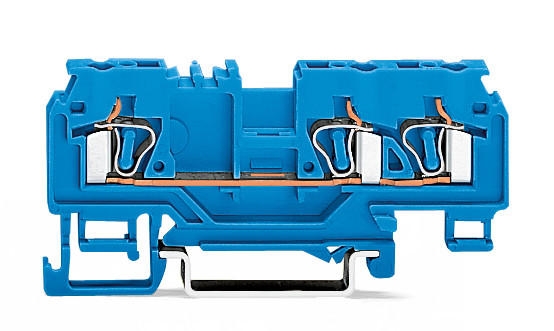

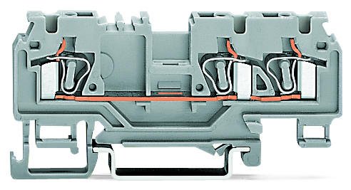

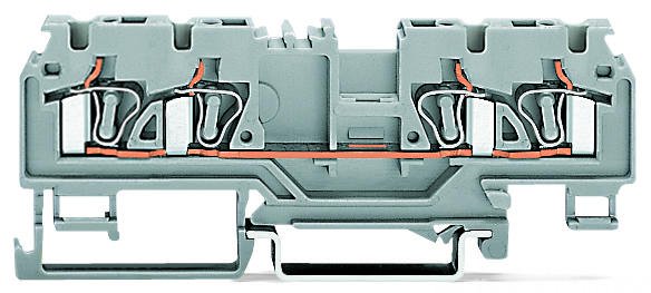

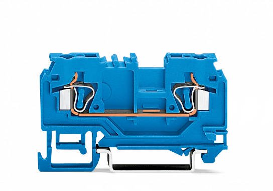

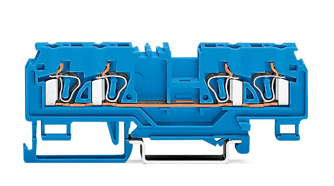

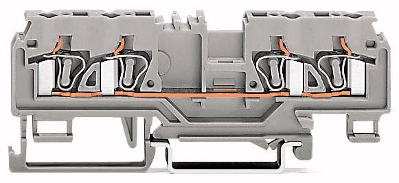

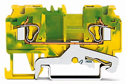

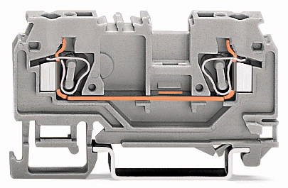

Parameters / Models | 880-308![]() | 880-309![]() | 880-325![]() | 880-326![]() | 880-328![]() | 880-329![]() | 880-339![]() | 880-340![]() | 880-344![]() | 880-345![]() | 880-346![]() | 880-347![]() | 880-661![]() | 880-661/999-940![]() | 880-662![]() | 880-662/999-940![]() | 880-664![]() | 880-664/999-940![]() | 880-681![]() | 880-681/999-940![]() | 880-682![]() | 880-682/999-940![]() | 880-684![]() | 880-684/999-940![]() | 880-687![]() | 880-687/999-940![]() | 880-831![]() | 880-831/999-940![]() | 880-832![]() | 880-832/999-940![]() | 880-834![]() | 880-834/999-940![]() | 880-837![]() | 880-837/999-940![]() | 880-901![]() | 880-901/999-940![]() | 880-902![]() | 880-902/999-940![]() | 880-904![]() | 880-904/999-940![]() | 880-907![]() | 880-907/999-940![]() | 880-961![]() | 880-961/999-940![]() | 880-962![]() | 880-962/999-940![]() | 880-964/999-940![]() |
Actuation type | Operating tool | Operating tool | Operating tool | Operating tool | Operating tool | Operating tool | Operating tool | Operating tool | Operating tool | Operating tool | Operating tool | Operating tool | Operating tool | Operating tool | Operating tool | Operating tool | Operating tool | Operating tool | Operating tool | Operating tool | Operating tool | Operating tool | Operating tool | Operating tool | Operating tool | Operating tool | Operating tool | Operating tool | Operating tool | Operating tool | Operating tool | Operating tool | Operating tool | Operating tool | Operating tool | ||||||||||||
Цвет | gray | gray | gray | gray | orange | orange | orange | orange | gray | gray | orange | orange | gray | gray | orange | orange | blue | blue | gray | gray | orange | orange | blue | blue | green-yellow | green-yellow | gray | gray | orange | orange | blue | blue | green-yellow | green-yellow | gray | gray | orange | orange | blue | blue | green-yellow | green-yellow | gray | gray | orange | orange | blue |
Connectable conductor materials | Copper | Copper | Copper | Copper | Copper | Copper | Copper | Copper | Copper | Copper | Copper | Copper | Copper | Copper | Copper | Copper | Copper | Copper | Copper | Copper | Copper | Copper | Copper | Copper | Copper | Copper | Copper | Copper | Copper | Copper | Copper | Copper | Copper | Copper | Copper | ||||||||||||
Connection technology | CAGE CLAMP® | CAGE CLAMP® | CAGE CLAMP® | CAGE CLAMP® | CAGE CLAMP® | CAGE CLAMP® | CAGE CLAMP® | CAGE CLAMP® | CAGE CLAMP® | CAGE CLAMP® | CAGE CLAMP® | CAGE CLAMP® | CAGE CLAMP® | CAGE CLAMP® | CAGE CLAMP® | CAGE CLAMP® | CAGE CLAMP® | CAGE CLAMP® | CAGE CLAMP® | CAGE CLAMP® | CAGE CLAMP® | CAGE CLAMP® | CAGE CLAMP® | CAGE CLAMP® | CAGE CLAMP® | CAGE CLAMP® | CAGE CLAMP® | CAGE CLAMP® | CAGE CLAMP® | CAGE CLAMP® | CAGE CLAMP® | CAGE CLAMP® | CAGE CLAMP® | CAGE CLAMP® | CAGE CLAMP® | ||||||||||||
Country of origin | DE | DE | DE | DE | DE | DE | DE | DE | DE | DE | DE | DE | DE | DE | DE | DE | DE | DE | PL | PL | PL | PL | PL | PL | DE | DE | PL | PL | PL | PL | PL | PL | DE | DE | PL | PL | PL | PL | PL | PL | DE | DE | DE | DE | |||
Габариты: глубина | 72.7 mm / 2.862 inch | 72.7 mm / 2.862 inch | 58.5 mm / 2.303 inch | 58.5 mm / 2.303 inch | 58.5 mm / 2.303 inch | 58.5 mm / 2.303 inch | 72.7 mm / 2.862 inch | 72.7 mm / 2.862 inch | 86.7 mm / 3.413 inch | 86.9 mm / 3.421 inch | 86.7 mm / 3.413 inch | 86.9 mm / 3.421 inch | 92.5 mm / 3.642 inch | 92.5 mm / 3.642 inch | 92.5 mm / 3.642 inch | 92.5 mm / 3.642 inch | 92.5 mm / 3.642 inch | 92.5 mm / 3.642 inch | 73 mm / 2.874 inch | 73 mm / 2.874 inch | 73 mm / 2.874 inch | 73 mm / 2.874 inch | 73 mm / 2.874 inch | 73 mm / 2.874 inch | 73 mm / 2.874 inch | 73 mm / 2.874 inch | 87 mm / 3.425 inch | 87 mm / 3.425 inch | 87 mm / 3.425 inch | 87 mm / 3.425 inch | 87 mm / 3.425 inch | 87 mm / 3.425 inch | 87 mm / 3.425 inch | 87 mm / 3.425 inch | 58.5 mm / 2.303 inch | 58.5 mm / 2.303 inch | 58.5 mm / 2.303 inch | 58.5 mm / 2.303 inch | 58.5 mm / 2.303 inch | 58.5 mm / 2.303 inch | 58.5 mm / 2.303 inch | 58.5 mm / 2.303 inch | 79 mm / 3.11 inch | 79 mm / 3.11 inch | 79 mm / 3.11 inch | 79 mm / 3.11 inch | 79 mm / 3.11 inch |
Design | horizontal | horizontal | horizontal | horizontal | horizontal | horizontal | horizontal | horizontal | horizontal | horizontal | horizontal | horizontal | horizontal | horizontal | horizontal | horizontal | horizontal | horizontal | horizontal | horizontal | horizontal | horizontal | horizontal | horizontal | horizontal | horizontal | horizontal | horizontal | horizontal | horizontal | horizontal | horizontal | horizontal | horizontal | horizontal | ||||||||||||
Fine-stranded conductor | 0.08 … 4 mm² / 28 … 12 AWG | 0.08 … 4 mm² / 28 … 12 AWG | 0.08 … 4 mm² / 28 … 12 AWG | 0.08 … 4 mm² / 28 … 12 AWG | 0.08 … 4 mm² / 28 … 12 AWG | 0.08 … 4 mm² / 28 … 12 AWG | 0.08 … 4 mm² / 28 … 12 AWG | 0.08 … 4 mm² / 28 … 12 AWG | 0.08 … 4 mm² / 28 … 12 AWG | 0.08 … 4 mm² / 28 … 12 AWG | 0.08 … 4 mm² / 28 … 12 AWG | 0.08 … 4 mm² / 28 … 12 AWG | 0.08 … 4 mm² / 28 … 12 AWG | 0.08 … 4 mm² / 28 … 12 AWG | 0.08 … 4 mm² / 28 … 12 AWG | 0.08 … 4 mm² / 28 … 12 AWG | 0.08 … 4 mm² / 28 … 12 AWG | 0.08 … 4 mm² / 28 … 12 AWG | 0.08 … 4 mm² / 28 … 12 AWG | 0.08 … 4 mm² / 28 … 12 AWG | 0.08 … 4 mm² / 28 … 12 AWG | 0.08 … 4 mm² / 28 … 12 AWG | 0.08 … 4 mm² / 28 … 12 AWG | 0.08 … 4 mm² / 28 … 12 AWG | 0.08 … 4 mm² / 28 … 12 AWG | 0.08 … 4 mm² / 28 … 12 AWG | 0.08 … 4 mm² / 28 … 12 AWG | 0.08 … 4 mm² / 28 … 12 AWG | 0.08 … 4 mm² / 28 … 12 AWG | 0.08 … 4 mm² / 28 … 12 AWG | 0.08 … 4 mm² / 28 … 12 AWG | 0.08 … 4 mm² / 28 … 12 AWG | 0.08 … 4 mm² / 28 … 12 AWG | 0.08 … 4 mm² / 28 … 12 AWG | 0.08 … 4 mm² / 28 … 12 AWG | ||||||||||||
Fire load, MJ | 0.11 | 0.084 | 0.089 | 0.069 | 0.086 | 0.068 | 0.11 | 0.083 | 0.12 | 0.09 | 0.128 | 0.09 | 0.147 | 0.148 | 0.147 | 0.147 | 0.147 | 0.147 | 0.147 | 0.147 | 0.147 | 0.147 | 0.147 | 0.147 | 0.127 | 0.12 | 0.176 | 0.175 | 0.176 | 0.175 | 0.176 | 0.175 | 0.157 | 0.154 | 0.12 | 0.12 | 0.12 | 0.12 | 0.12 | 0.121 | 0.103 | 0.093 | |||||
GTIN | 4017332362047 | 4017332362054 | 4017332362023 | 4017332362030 | 4017332361941 | 4017332361989 | 4017332361965 | 4017332362009 | 4017332650915 | 4017332650922 | 4017332650939 | 4017332650946 | 4017332363808 | 4017332650953 | 4017332363822 | 4017332650960 | 4017332363815 | 4017332650977 | 4044918519922 | 4044918519939 | 4044918519960 | 4044918519984 | 4044918520034 | 4044918520058 | 4045454084769 | 4045454084783 | 4044918560757 | 4044918560771 | 4044918560788 | 4044918560795 | 4044918560832 | 4044918560863 | 4045454084790 | 4045454084806 | 4044918484671 | 4044918484688 | 4044918484718 | 4044918484725 | 4044918484756 | 4044918484763 | 4045454121167 | 4045454121181 | 4017332363778 | 4017332651219 | 4017332363792 | 4017332651226 | 4017332651233 |
Height | 28.6 mm / 1.126 inch | 27.1 mm / 1.067 inch | 28.6 mm / 1.126 inch | 27.1 mm / 1.067 inch | 28.6 mm / 1.126 inch | 27.1 mm / 1.067 inch | 28.6 mm / 1.126 inch | 27.1 mm / 1.067 inch | 28.6 mm / 1.126 inch | 27.1 mm / 1.067 inch | 28.6 mm / 1.126 inch | 27.1 mm / 1.067 inch | |||||||||||||||||||||||||||||||||||
Height from upper-edge of DIN-35 rail | 29 mm / 1.142 inch | 29 mm / 1.142 inch | 29 mm / 1.142 inch | 29 mm / 1.142 inch | 29 mm / 1.142 inch | 29 mm / 1.142 inch | 29 mm / 1.142 inch | 29 mm / 1.142 inch | 29 mm / 1.142 inch | 29 mm / 1.142 inch | 29 mm / 1.142 inch | 29 mm / 1.142 inch | 29 mm / 1.142 inch | 29 mm / 1.142 inch | 29 mm / 1.142 inch | 29 mm / 1.142 inch | 29 mm / 1.142 inch | 29 mm / 1.142 inch | 29 mm / 1.142 inch | 29 mm / 1.142 inch | 29 mm / 1.142 inch | 29 mm / 1.142 inch | 29 mm / 1.142 inch | 29 mm / 1.142 inch | 29 mm / 1.142 inch | 29 mm / 1.142 inch | 29 mm / 1.142 inch | 29 mm / 1.142 inch | 29 mm / 1.142 inch | 29 mm / 1.142 inch | 29 mm / 1.142 inch | 29 mm / 1.142 inch | 29 mm / 1.142 inch | 29 mm / 1.142 inch | 29 mm / 1.142 inch | ||||||||||||
Insulating material | Polyamide 66 (PA 66) | Polyamide 66 (PA 66) | Polyamide 66 (PA 66) | Polyamide 66 (PA 66) | Polyamide 66 (PA 66) | Polyamide 66 (PA 66) | Polyamide 66 (PA 66) | Polyamide 66 (PA 66) | Polyamide 66 (PA 66) | Polyamide 66 (PA 66) | Polyamide 66 (PA 66) | Polyamide 66 (PA 66) | Polyamide 66 (PA 66) | Polyamide 66 (PA 66) | Polyamide 66 (PA 66) | Polyamide 66 (PA 66) | Polyamide 66 (PA 66) | Polyamide 66 (PA 66) | Polyamide 66 (PA 66) | Polyamide 66 (PA 66) | Polyamide 66 (PA 66) | Polyamide 66 (PA 66) | Polyamide 66 (PA 66) | Polyamide 66 (PA 66) | Polyamide 66 (PA 66) | Polyamide 66 (PA 66) | Polyamide 66 (PA 66) | Polyamide 66 (PA 66) | Polyamide 66 (PA 66) | Polyamide 66 (PA 66) | Polyamide 66 (PA 66) | Polyamide 66 (PA 66) | Polyamide 66 (PA 66) | Polyamide 66 (PA 66) | Polyamide 66 (PA 66) | ||||||||||||
Legend (ratings) | (III / 3) ≙ Overvoltage category III / Pollution degree 3 | (III / 3) ≙ Overvoltage category III / Pollution degree 3 | (III / 3) ≙ Overvoltage category III / Pollution degree 3 | (III / 3) ≙ Overvoltage category III / Pollution degree 3 | (III / 3) ≙ Overvoltage category III / Pollution degree 3 | (III / 3) ≙ Overvoltage category III / Pollution degree 3 | (III / 3) ≙ Overvoltage category III / Pollution degree 3 | (III / 3) ≙ Overvoltage category III / Pollution degree 3 | (III / 3) ≙ Overvoltage category III / Pollution degree 3 | (III / 3) ≙ Overvoltage category III / Pollution degree 3 | (III / 3) ≙ Overvoltage category III / Pollution degree 3 | (III / 3) ≙ Overvoltage category III / Pollution degree 3 | (III / 3) ≙ Overvoltage category III / Pollution degree 3 | (III / 3) ≙ Overvoltage category III / Pollution degree 3 | (III / 3) ≙ Overvoltage category III / Pollution degree 3 | (III / 3) ≙ Overvoltage category III / Pollution degree 3 | (III / 3) ≙ Overvoltage category III / Pollution degree 3 | (III / 3) ≙ Overvoltage category III / Pollution degree 3 | (III / 3) ≙ Overvoltage category III / Pollution degree 3 | (III / 3) ≙ Overvoltage category III / Pollution degree 3 | (III / 3) ≙ Overvoltage category III / Pollution degree 3 | (III / 3) ≙ Overvoltage category III / Pollution degree 3 | (III / 3) ≙ Overvoltage category III / Pollution degree 3 | (III / 3) ≙ Overvoltage category III / Pollution degree 3 | (III / 3) ≙ Overvoltage category III / Pollution degree 3 | (III / 3) ≙ Overvoltage category III / Pollution degree 3 | (III / 3) ≙ Overvoltage category III / Pollution degree 3 | (III / 3) ≙ Overvoltage category III / Pollution degree 3 | (III / 3) ≙ Overvoltage category III / Pollution degree 3 | ||||||||||||||||||
Marking level | Center marking | Center marking | Center marking | Center marking | Center marking | Center marking | Center marking | Center marking | Center marking | Center marking | Center marking | Center marking | Center/side marking | Center/side marking | Center marking | Center marking | Center marking | Center marking | Center marking | Center marking | Center/side marking | Center/side marking | Center marking | Center marking | Center marking | Center marking | Center marking | Center marking | Center/side marking | Center/side marking | Center marking | Center marking | Center marking | Center marking | Center marking | ||||||||||||
Number of levels | 1 | 1 | 1 | 1 | 1 | 1 | 1 | 1 | 1 | 1 | 1 | 1 | 1 | 1 | 1 | 1 | 1 | 1 | 1 | 1 | 1 | 1 | 1 | 1 | 1 | 1 | 1 | 1 | 1 | 1 | 1 | 1 | 1 | 1 | 1 | ||||||||||||
Product Group | 1 (Rail Mounted Terminal Blocks) | 1 (Rail Mounted Terminal Blocks) | 1 (Rail Mounted Terminal Blocks) | 1 (Rail Mounted Terminal Blocks) | 1 (Rail Mounted Terminal Blocks) | 1 (Rail Mounted Terminal Blocks) | 1 (Rail Mounted Terminal Blocks) | 1 (Rail Mounted Terminal Blocks) | 1 (Rail Mounted Terminal Blocks) | 1 (Rail Mounted Terminal Blocks) | 1 (Rail Mounted Terminal Blocks) | 1 (Rail Mounted Terminal Blocks) | 1 (Rail Mounted Terminal Blocks) | 1 (Rail Mounted Terminal Blocks) | 1 (Rail Mounted Terminal Blocks) | 1 (Rail Mounted Terminal Blocks) | 1 (Rail Mounted Terminal Blocks) | 1 (Rail Mounted Terminal Blocks) | 1 (Rail Mounted Terminal Blocks) | 1 (Rail Mounted Terminal Blocks) | 1 (Rail Mounted Terminal Blocks) | 1 (Rail Mounted Terminal Blocks) | 1 (Rail Mounted Terminal Blocks) | 1 (Rail Mounted Terminal Blocks) | 1 (Rail Mounted Terminal Blocks) | 1 (Rail Mounted Terminal Blocks) | 1 (Rail Mounted Terminal Blocks) | 1 (Rail Mounted Terminal Blocks) | 1 (Rail Mounted Terminal Blocks) | 1 (Rail Mounted Terminal Blocks) | 1 (Rail Mounted Terminal Blocks) | 1 (Rail Mounted Terminal Blocks) | 1 (Rail Mounted Terminal Blocks) | 1 (Rail Mounted Terminal Blocks) | 1 (Rail Mounted Terminal Blocks) | 1 (Rail Mounted Terminal Blocks) | 1 (Rail Mounted Terminal Blocks) | ||||||||||
Rated current, A | 25 | 25 | 25 | 25 | 25 | 25 | 25 | 25 | 25 | 25 | 25 | 25 | 20 | 20 | 20 | 20 | 20 | 20 | 25 | 25 | 25 | 25 | 25 | 25 | 25 | 25 | 25 | 25 | 25 | ||||||||||||||||||
Rated impulse voltage (III / 3), kV | 6 | 6 | 6 | 6 | 6 | 6 | 8 | 8 | 8 | 8 | 8 | 8 | 8 | 8 | 8 | 8 | 8 | 8 | 8 | 8 | 8 | 8 | 8 | 8 | 6 | 6 | 6 | 6 | 6 | ||||||||||||||||||
Rated voltage (III / 3), В | 400 | 400 | 400 | 400 | 400 | 400 | 800 | 800 | 800 | 800 | 800 | 800 | 800 | 800 | 800 | 800 | 800 | 800 | 800 | 800 | 800 | 800 | 800 | 800 | 400 | 400 | 400 | 400 | 400 | ||||||||||||||||||
Solid conductor | 0.08 … 4 mm² / 28 … 12 AWG | 0.08 … 4 mm² / 28 … 12 AWG | 0.08 … 4 mm² / 28 … 12 AWG | 0.08 … 4 mm² / 28 … 12 AWG | 0.08 … 4 mm² / 28 … 12 AWG | 0.08 … 4 mm² / 28 … 12 AWG | 0.08 … 4 mm² / 28 … 12 AWG | 0.08 … 4 mm² / 28 … 12 AWG | 0.08 … 4 mm² / 28 … 12 AWG | 0.08 … 4 mm² / 28 … 12 AWG | 0.08 … 4 mm² / 28 … 12 AWG | 0.08 … 4 mm² / 28 … 12 AWG | 0.08 … 4 mm² / 28 … 12 AWG | 0.08 … 4 mm² / 28 … 12 AWG | 0.08 … 4 mm² / 28 … 12 AWG | 0.08 … 4 mm² / 28 … 12 AWG | 0.08 … 4 mm² / 28 … 12 AWG | 0.08 … 4 mm² / 28 … 12 AWG | 0.08 … 4 mm² / 28 … 12 AWG | 0.08 … 4 mm² / 28 … 12 AWG | 0.08 … 4 mm² / 28 … 12 AWG | 0.08 … 4 mm² / 28 … 12 AWG | 0.08 … 4 mm² / 28 … 12 AWG | 0.08 … 4 mm² / 28 … 12 AWG | 0.08 … 4 mm² / 28 … 12 AWG | 0.08 … 4 mm² / 28 … 12 AWG | 0.08 … 4 mm² / 28 … 12 AWG | 0.08 … 4 mm² / 28 … 12 AWG | 0.08 … 4 mm² / 28 … 12 AWG | 0.08 … 4 mm² / 28 … 12 AWG | 0.08 … 4 mm² / 28 … 12 AWG | 0.08 … 4 mm² / 28 … 12 AWG | 0.08 … 4 mm² / 28 … 12 AWG | 0.08 … 4 mm² / 28 … 12 AWG | 0.08 … 4 mm² / 28 … 12 AWG | ||||||||||||
Strip length | 8 … 9 mm / 0.31 … 0.35 Inch | 8 … 9 mm / 0.31 … 0.35 Inch | 8 … 9 mm / 0.31 … 0.35 Inch | 8 … 9 mm / 0.31 … 0.35 Inch | 8 … 9 mm / 0.31 … 0.35 Inch | 8 … 9 mm / 0.31 … 0.35 Inch | 8 … 9 mm / 0.31 … 0.35 Inch | 8 … 9 mm / 0.31 … 0.35 Inch | 8 … 9 mm / 0.31 … 0.35 Inch | 8 … 9 mm / 0.31 … 0.35 Inch | 8 … 9 mm / 0.31 … 0.35 Inch | 8 … 9 mm / 0.31 … 0.35 Inch | 8 … 9 mm / 0.31 … 0.35 Inch | 8 … 9 mm / 0.31 … 0.35 Inch | 8 … 9 mm / 0.31 … 0.35 Inch | 8 … 9 mm / 0.31 … 0.35 Inch | 8 … 9 mm / 0.31 … 0.35 Inch | 8 … 9 mm / 0.31 … 0.35 Inch | 8 … 9 mm / 0.31 … 0.35 Inch | 8 … 9 mm / 0.31 … 0.35 Inch | 8 … 9 mm / 0.31 … 0.35 Inch | 8 … 9 mm / 0.31 … 0.35 Inch | 8 … 9 mm / 0.31 … 0.35 Inch | 8 … 9 mm / 0.31 … 0.35 Inch | 8 … 9 mm / 0.31 … 0.35 Inch | 8 … 9 mm / 0.31 … 0.35 Inch | 8 … 9 mm / 0.31 … 0.35 Inch | 8 … 9 mm / 0.31 … 0.35 Inch | 8 … 9 mm / 0.31 … 0.35 Inch | 8 … 9 mm / 0.31 … 0.35 Inch | 8 … 9 mm / 0.31 … 0.35 Inch | 8 … 9 mm / 0.31 … 0.35 Inch | 8 … 9 mm / 0.31 … 0.35 Inch | 8 … 9 mm / 0.31 … 0.35 Inch | 8 … 9 mm / 0.31 … 0.35 Inch | ||||||||||||
Total number of connection points | 3 | 3 | 3 | 3 | 3 | 3 | 3 | 3 | 3 | 3 | 3 | 3 | 3 | 3 | 4 | 4 | 4 | 4 | 4 | 4 | 4 | 4 | 2 | 2 | 2 | 2 | 2 | 2 | 2 | 2 | 2 | 2 | 2 | 2 | 2 | ||||||||||||
Total number of potentials | 1 | 1 | 1 | 1 | 1 | 1 | 1 | 1 | 1 | 1 | 1 | 1 | 1 | 1 | 1 | 1 | 1 | 1 | 1 | 1 | 1 | 1 | 1 | 1 | 1 | 1 | 1 | 1 | 1 | 1 | 1 | 1 | 1 | 1 | 1 | ||||||||||||
Type of mounting | DIN-35 rail | DIN-35 rail | DIN-35 rail | DIN-35 rail | DIN-35 rail | DIN-35 rail | DIN-35 rail | DIN-35 rail | DIN-35 rail | DIN-35 rail | DIN-35 rail | DIN-35 rail | DIN-35 rail | DIN-35 rail | DIN-35 rail | DIN-35 rail | DIN-35 rail | DIN-35 rail | DIN-35 rail | DIN-35 rail | DIN-35 rail | DIN-35 rail | DIN-35 rail | DIN-35 rail | DIN-35 rail | DIN-35 rail | DIN-35 rail | DIN-35 rail | DIN-35 rail | DIN-35 rail | DIN-35 rail | DIN-35 rail | DIN-35 rail | DIN-35 rail | DIN-35 rail | ||||||||||||
Type of wiring | Front-entry wiring | Front-entry wiring | Front-entry wiring | Front-entry wiring | Front-entry wiring | Front-entry wiring | Front-entry wiring | Front-entry wiring | Front-entry wiring | Front-entry wiring | Front-entry wiring | Front-entry wiring | Front-entry wiring | Front-entry wiring | Front-entry wiring | Front-entry wiring | Front-entry wiring | Front-entry wiring | Front-entry wiring | Front-entry wiring | Front-entry wiring | Front-entry wiring | Front-entry wiring | Front-entry wiring | Front-entry wiring | Front-entry wiring | Front-entry wiring | Front-entry wiring | Front-entry wiring | Front-entry wiring | Front-entry wiring | Front-entry wiring | Front-entry wiring | Front-entry wiring | Front-entry wiring | ||||||||||||
Вес, г | 3.6 | 3 | 2.9 | 2.326 | 2.867 | 2.2 | 3.6 | 2.8 | 4.4 | 3 | 4.45 | 3 | 10.701 | 10.721 | 10.701 | 10.711 | 10.701 | 10.711 | 8.679 | 8.679 | 8.679 | 8.679 | 8.679 | 8.679 | 12.139 | 11.899 | 10.784 | 10.734 | 10.784 | 10.734 | 10.784 | 12 | 14.284 | 14.194 | 6.473 | 6.473 | 6.473 | 6.473 | 6.473 | 6.503 | 10.061 | 9.693 | 8.155 | 1.111 | 8.155 | 1.111 | 1.111 |
Ширина | 2.5 mm / 0.098 inch | 2 mm / 0.079 inch | 2.5 mm / 0.098 inch | 2 mm / 0.079 inch | 2.5 mm / 0.098 inch | 2 mm / 0.079 inch | 2.5 mm / 0.098 inch | 2 mm / 0.079 inch | 2.5 mm / 0.098 inch | 2 mm / 0.079 inch | 2.5 mm / 0.098 inch | 2 mm / 0.079 inch | 5 mm / 0.197 inch | 5 mm / 0.197 inch | 5 mm / 0.197 inch | 5 mm / 0.197 inch | 5 mm / 0.197 inch | 5 mm / 0.197 inch | 5 mm / 0.197 inch | 5 mm / 0.197 inch | 5 mm / 0.197 inch | 5 mm / 0.197 inch | 5 mm / 0.197 inch | 5 mm / 0.197 inch | 5 mm / 0.197 inch | 5 mm / 0.197 inch | 5 mm / 0.197 inch | 5 mm / 0.197 inch | 5 mm / 0.197 inch | 5 mm / 0.197 inch | 5 mm / 0.197 inch | 5 mm / 0.197 inch | 5 mm / 0.197 inch | 5 mm / 0.197 inch | 5 mm / 0.197 inch | 5 mm / 0.197 inch | 5 mm / 0.197 inch | 5 mm / 0.197 inch | 5 mm / 0.197 inch | 5 mm / 0.197 inch | 5 mm / 0.197 inch | 5 mm / 0.197 inch | 5 mm / 0.197 inch | 5 mm / 0.197 inch | 5 mm / 0.197 inch | 5 mm / 0.197 inch | 5 mm / 0.197 inch |
