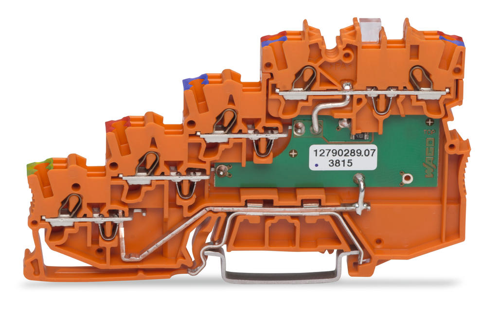

Клеммная колодка светодиода датчика TOPJOB S; зеленый светодиод; с заземляющим контактом; внутренне объединенный; 2-полюсный; монтаж на рейку; 4-проводной; ширина 7 мм; оранжевый

Actuation type | Open Tool Slot |
Цвет | orange |
Connectable conductor materials | Copper |
Connection technology | Push-in CAGE CLAMP® |
Country of origin | DE |
Design | horizontal |
Fine-stranded conductor | 0.14 … 1.5 mm² / 24 … 16 AWG |
Fine-stranded conductor with ferrule, push-in termination, from | 0.5 mm² / 20 AWG |
GTIN | 4055143452847 |
Height from upper-edge of DIN-35 rail | 52.4 mm / 2.063 inch |
Marking level | Center/side marking |
Nominal cross section | 1 mm² |
Nominal voltage | 24 В |
Solid conductor | 0.14 … 1.5 mm² / 24 … 16 AWG |
Solid conductor, push-in termination | 0.5 … 1.5 mm² / 20 … 16 AWG |
Strip length | 9 … 11 mm / 0.35 … 0.43 Inch |
Total number of connection points | 10 |
Total number of potentials | 5 |
Type of mounting | DIN-35 rail |
Type of wiring | Front-entry wiring |
Voltage type (1) | DC |
Вес | 21.697 г |
Ширина | 7 mm / 0.276 inch |
