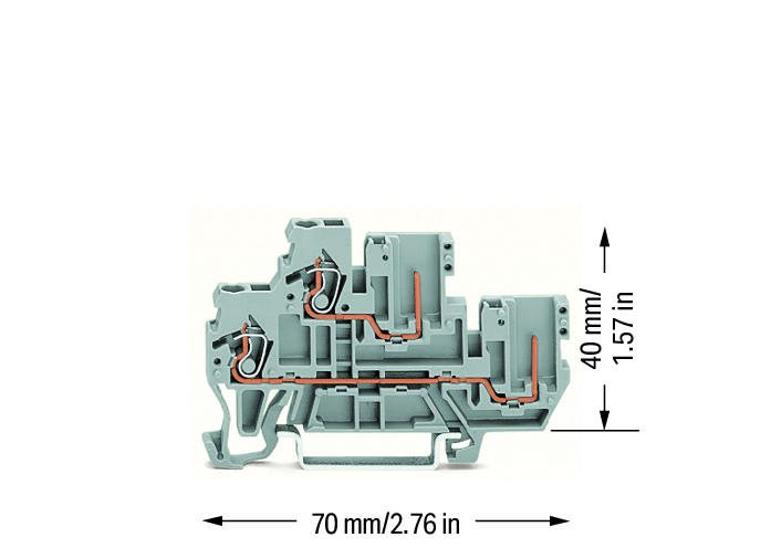

Actuation type | Operating tool |
Цвет | gray |
Connectable conductor materials | Copper |
Connection technology | CAGE CLAMP® |
Country of origin | DE |
Габариты: глубина | 70 mm / 2.756 inch |
Design | horizontal |
Fine-stranded conductor | 0.08 … 4 mm² / 28 … 12 AWG |
Fire load | 0.163 MJ |
GTIN | 4045454004446 |
Height from upper-edge of DIN-35 rail | 40 mm / 1.575 inch |
Legend (ratings) | (III / 3) ≙ Overvoltage category III / Pollution degree 3 |
Marking level | Side marking |
Number of levels | 2 |
Potential marking | L/L |
Rated current | 16 A |
Rated impulse voltage (III / 3) | 6 kV |
Rated voltage (III / 3) | 500 В |
Solid conductor | 0.08 … 2.5 mm² / 28 … 12 AWG |
Strip length | 6 … 7 mm / 0.24 … 0.28 Inch |
Total number of connection points | 2 |
Total number of potentials | 2 |
Type of mounting | DIN-35 rail |
Type of wiring | Front-entry wiring |
Вес | 9.106 г |
Ширина | 5 mm / 0.197 inch |
