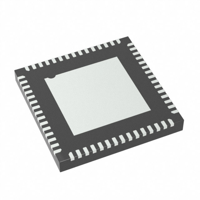

Parameters / ModelsADC11DS105CISQE/NOPB
# Input Channels2
Analog Input BW, МГц1000
АрхитектураPipeline
DNL(Max), +/-LSB0.5
DNL(Typ), +/-LSB0.2
ENOB, Bits10.9
INL(Max), +/-LSB0.75
INL(Typ), +/-LSB0.25
Input BufferNo
Input Range, Vp-p2
InterfaceSerial LVDS
Рабочий диапазон температур, Cот -40 до 85
Package GroupWQFN
Package Size: mm2:W x L, PKG60WQFN: 81 mm2: 9 x 9(WQFN)
Power Consumption(Typ), mW1000
RatingCatalog
Reference ModeExt,Int
Разрешение, Bits11
SFDR, дБ82
SINAD, дБ67.4
SNR, дБ66
Sample Rate(Max), MSPS105
